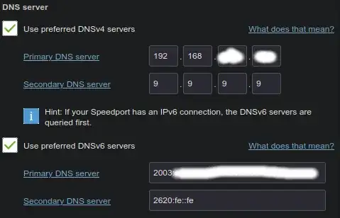

Then, I configured my Speedport router to use my local server IP as DNS resolver:
router configuration

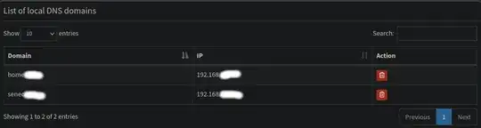

Then, I tried to setup local DNS addresses on pi-hole to be able to access certain machines locally using domains, let's say home.local pointing to my server address on 192.168.x.123:
local DNS domains
However, neither my android phone connected to my WiFi nor the Ubuntu PC I'm writing this text from is able to resolve those addresses.
