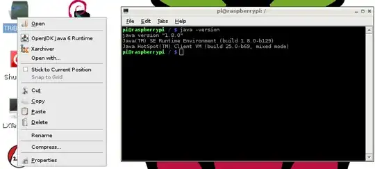

I have installed JDK 8 on my Pi but it is still showing JDK 6.. Photo for reference: java versions comparison
How to I change it so that applications use JDK 8 now? Thank you.

If 1.8 is what comes up for java -version (it does in your screenshot) then that is the one being used by default.
You should not have to change anything.

Like Goldilocks said, if java -version is showing 1.8, that is what is being used.
The only reason I can think that the desktop version is saying 1.6 is because the .desktop file for the JRE or the shortcut on the menu didn't get updated. I can't confirm this or give a way to fix it right now, as my Pi is fried :'( but everything should be using 1.8.

If for some reason it is actually using 6 to open the file, you can probably use the "Open with..." entry to specify the command line necessary to run a jar file, e.g. java -jar file.jar if I recall correctly, and specify that as the default run command. (You may need to hunt down the correct location for the Java 1.8 binary though first, not just the environment link.)
