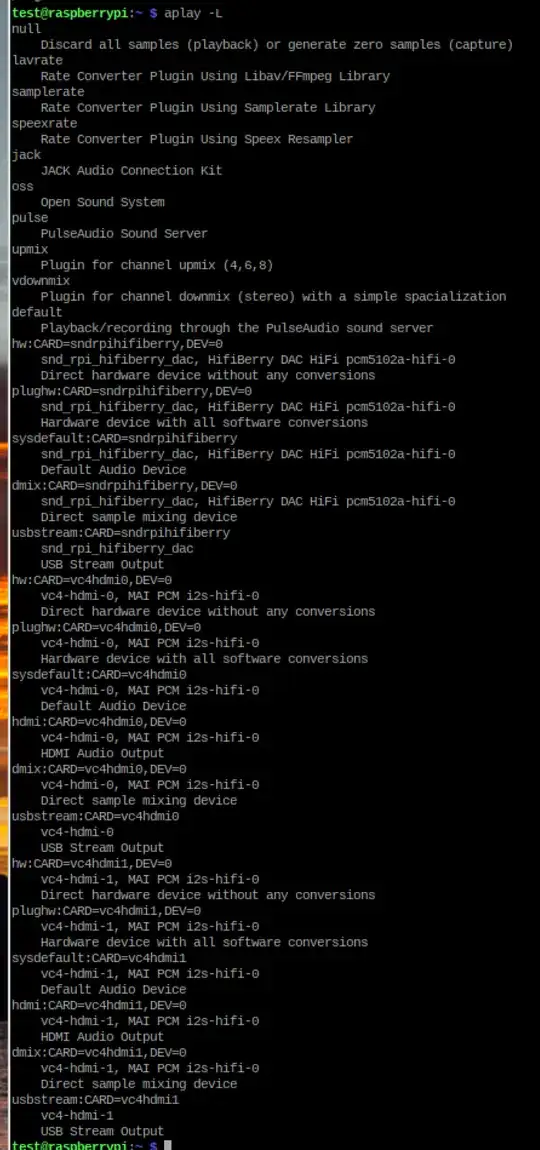

I followed the instructions at the two links the first link is based on the second but both have good info. I also attached a screenshot of the output from the command aplay -L and the sound card in alsamixer. It appears that the DAC device is showing up.

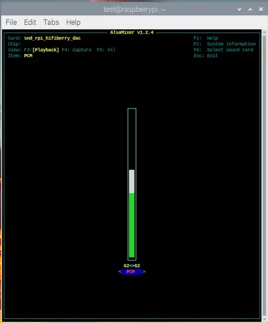

In that Adafruit tutorial in the asounds.conf file it has lines that say "type hw card 0" I changed these to "type hw card 1" and then the DAC device seemed to appear as an audio device I could select on the desktop tray. If I left it at 0 nothing ever appeared anywhere.

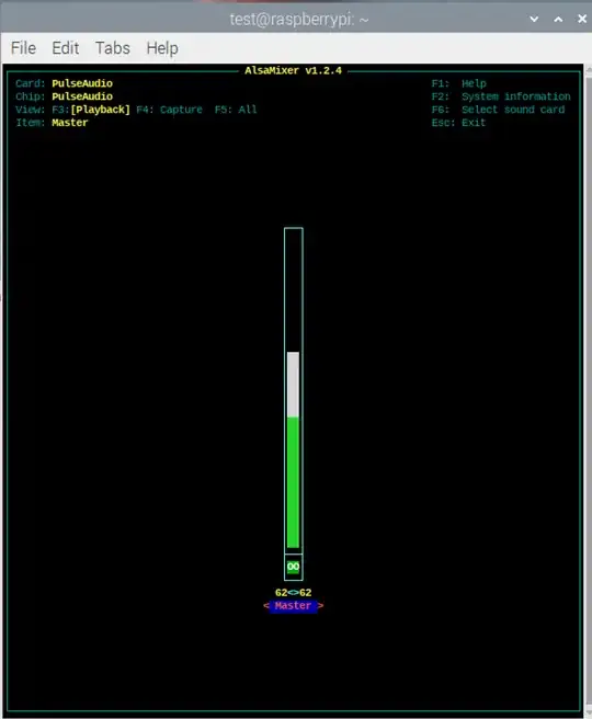

However AlsaMixer doesn't show this device by default it shows PulseAudio.
I am not sure what else I can try, I attempted to remove PulseAudio and that didn't seem to work. I also messed around with the alsa config files and managed to change my DAC to be the primary device but I don't know if I did it properly. There was no sound at all.

Terminal Output
AlsaMixer new DAC device that I added
AlsaMixer Default Device
