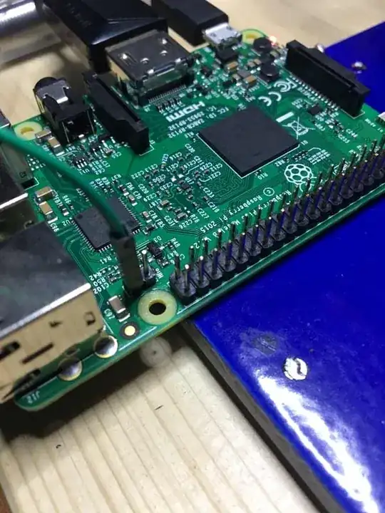

There is not a conventional reset pin. As in that there is no pin or button to push. Instead you can do the following as stated in this post on the Raspberry Pi forums.
Tap a 3K3 resistor between TP2 (ground) and the SoC end of R15. This works even in the new halt state. (The resistor is just to avoid shorting the 3V3 rail if you hit the wrong end. Anything from 1K to 33K will be fine.)
It is very easy to wire a hardware reset to the Rpi3.
Here is where you will find holes already open and waiting:
(Shown here with header pins soldered in place directly above the screw hole)
Don't use too much heat or solder. A little bit will do.
It is delicate underneath, with a thin trace.
I leave them just open, and use the green wire to briefly short them together.
Alternatively, connect to a momentary-on (NO) pushbutton.
