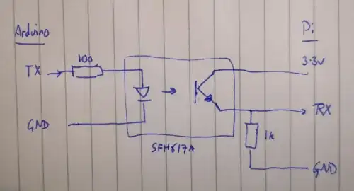

I've got a device (actually an arduino) that's sending serial data at 2400baud, 8N1. It's connected to my Pi Zero through optocouplers onto pin 8 and 10 (UART TX and UART RX). I've verified i'm seeing 3.3v signals onto the RX pin using a scope, it looks like i'd expect, a square wave representing digital data. For the software I'm using Java and the jSerialComm library to try and receive this data, but i'm having problems.

EDIT: Optocouplers are to isolate the two devices from each other as they operate at different potentials and I don't want ground loops. They are SFH617A, and they are not inverting the signal:
isolated serial

As alluded in the comments, and due to non-disclosure of the opto-couplers used & circuitry details, the most likely suspect is your opto-couplers. Since you have an oscilloscope, you can verify this:
  • on one channel, display the Arduino's serial output;
  • on the second channel, display the output of the optocpupler
If the two channels show a logic inversion, you may replace the optocoupler with a voltage divider - which should resolve your issue. Note that a level-shifter will also restore the correct phasing.
If my assumption re the optocoupler is incorrect, please let us know what part # you are using, and how you have it wired.
