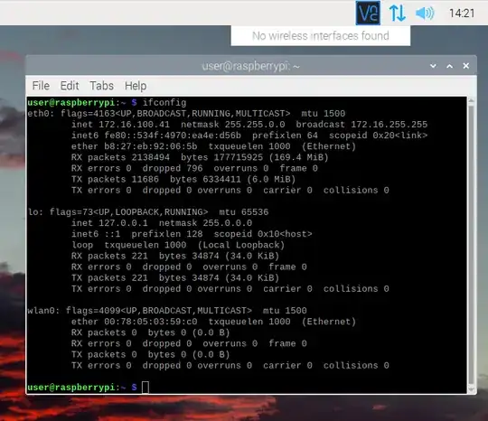

I also encountered this problem on a new image with the configuration below. The GUI shows "No wireless interfaces found", while at the same time, the usb wifi adapter already has working drivers and firmware included in the raspios image. The wlan0 interface is also working via ifconfig and iwlist.
  • Raspberry Pi 2 v1.1 BCM2836
  • New image of 2022-09-22-raspios-bullseye-armhf-full.img
  • USB Realtek Semiconductor Corp. RTL8188EUS 802.11n Wireless Network Adapter

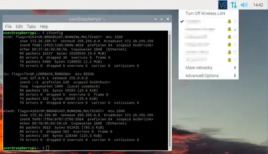

The solution is to:
  1. Run sudo raspi-config
  2. Choose 6 Advanced Options
  3. Choose AA Network Config
  4. And set Select the network configuration to use to 2 NetworkManager
  5. Exit and reboot.
The GUI can now be used to associate with access points.
