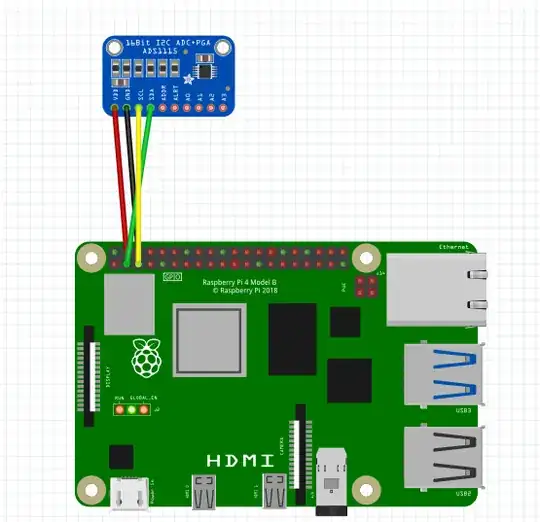

I'm having a hard time setting up a i2c device on a pi4. enter image description here

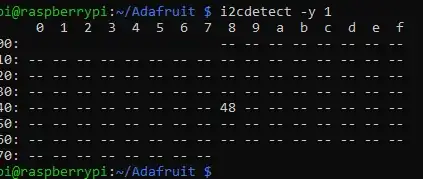

I did i2cdetect -y 1

and printing out the value for board.SCL and board.SDA its 3 and 2 respectively. Am I calling the i2c incorrectly?

I don't use Python for these things, but on my side of the tracks I have to make an entry in /boot/config.txt to enable the appropriate device tree overlay before the driver is able to connect to the device.
Assuming your device is the ADS1115, you can add the following entry to /boot/config.txt & reboot. Running i2cdetect -y 1 should show the symbol UU at address 48, indicating the driver has connected.
dtoverlay=ads1115 <options as required>
# Read  the file '/boot/overlays/README' to see the additional options that my need to be configured.
Alternatively, you can use the dtoverlay command to invoke the dynamic device tree. AIUI, this is not a permanent change, but may be useful for testing when it's not convenient to reboot. Also FWIW, last I tried the dynamic device tree, it seemed a rough and unfinished project - it may or may not have improved since.
