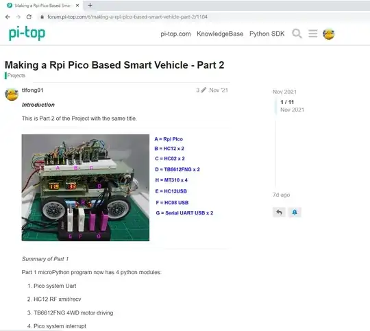

Appendix B - Old project notes on Pico based wireless robot
HC12 4WD 2022aug0501
