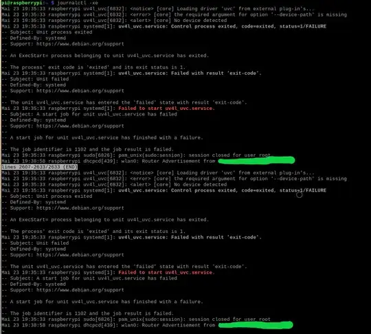

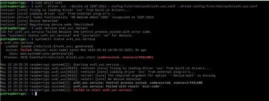

Then I tried it with lsusb to get the device id of my webcam and then
uv4l --driver uvc --device-id 328f:2013 --config-file=/etc/uv4l/uv4l-uvc.conf --driver-config-file=/etc/uv4l/uv4l-uvc.conf
but, when I then try to restart the service with sudo service uv4l_uvc restart: "Job for uv4l_uvc.service failed because the control process exited with error code. See "systemctl status uv4l_uvc.service" and "journalctl -xe" for details."

In case of problems, there is also a "--external-driver" option in uv4l which makes uv4l use the uvc kernel driver (if loaded) instead of its own userspace version (see the uv4l core manual).
