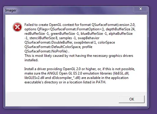

Imager Error msg
After installing Imager, it is failed to start showing the above error message. I have failed to find "ANGLE Open GL ES 2.0 emulation libraries" mentioned in the error message.
My spec: windows 7, core 2 duo, gigabyte g31m es2c main board, no external gpu.

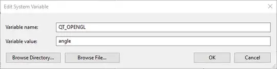

As of https://knowledge.autodesk.com/support/autocad/troubleshooting/caas/sfdcarticles/sfdcarticles/Error-Failed-to-create-OpenGL-context-for-format-QSurfaceFormat-when-launching-Fusion-360.html
  1. In window menu, search for "environment variables". or go to my computer > properties > Advanced system settings > environment variables
  2. in lower portion "system variables"
  3. click on "new", use
    variable name = QT_OPENGL
    variable value = angle
    click ok. variable entry window
  4. again create a new entry
    variable name = QT_ANGLE_PLATFORM
    variable value = warp
    click ok enter image description here
