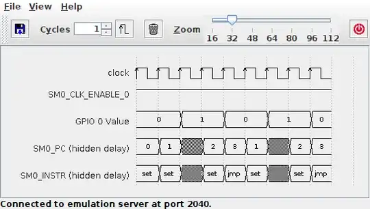

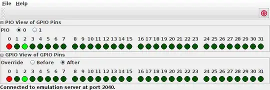

Whilst the following project looks to be abandoned 2 years ago, it does look pretty comprehensive...
docs: https://rp2040pio-docs.readthedocs.io/en/latest/index.html
code: https://github.com/soundpaint/rp2040pio
I haven't used it persoanlly. It looks like a fairly steep path getting started. It is Java based and requires building from source :(
Here are some pretty pictures of it in action...
