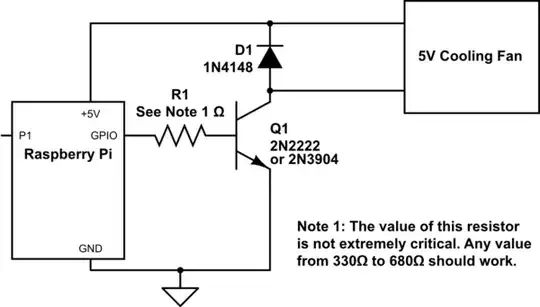

Turning a fan ON & OFF requires an external switch (e.g. transistor) as the GPIO pin itself is not up to the task. Instead - use the GPIO to control the transistor. Connect your 2-wire, 3.3V or 5V fan as shown in the diagram below. See the GPIO pinout page for available GPIO pins.

Add the overlay to /boot/config.txt as follows:
dtoverlay=gpio-fan,gpiopin=5,temp=60000
reboot to load the overlay. Using the settings above, your fan will turn on when the temperature reaches 60deg C & turn off when it falls a few degrees below that.
