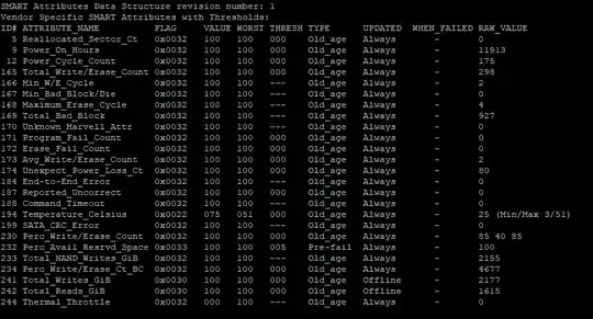

Smart Control result of the SSD: sudo smartctl -a /dev/sdc

it seems to be a power issue and I would do two things:
  1. get a USB power meter to understand where power might be missing
  2. check your USB power supplies to make sure these are not USB chargers as these adapt their delivery which might have adverse effects
Make sure the firmware of your enclosures is up-to-date! I had the same problem with my NVMe SSD enclosure with a JMicron JMS583 chipset – the connection kept dropping on my Pi 4 (which never happened when connected to a laptop) even though the SSD was getting more than enough power from a USB hub.
Turns out the vendor firmware the enclosure shipped with was actually based on an older version of the chipset manufacturer's firmware; since replacing it with the newest firmware directly from the manufacturer I haven't had any more issues.
P.S. Depending on the chipset, you might need to remove the SSD if you don't want to risk data loss.
