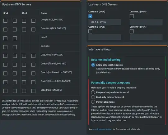

Expected Behaviour:

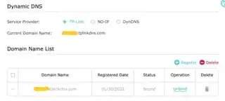

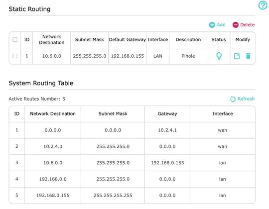

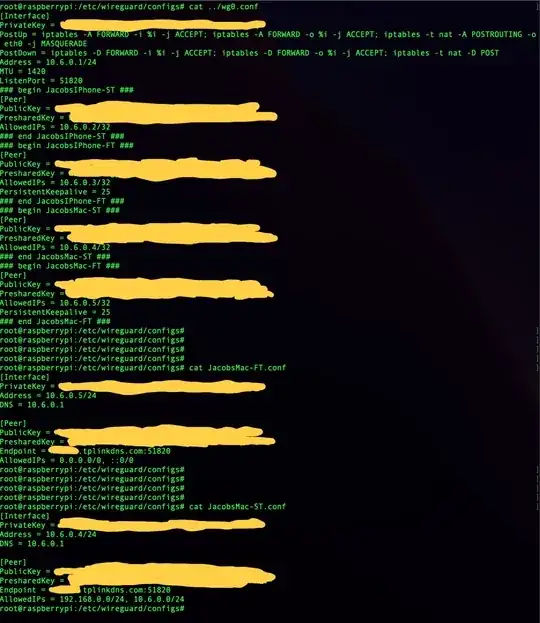

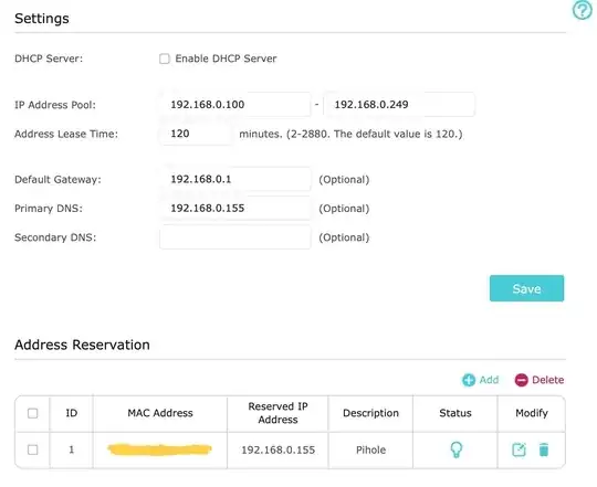

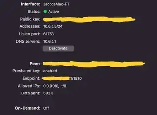

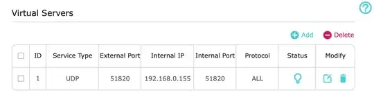

I've set my Router to use my PiHole along with Wireguard to use it as a VPN. I've set it up using PIVPN and some tutorials on Youtube. I have included Screenshots of my router and it's setup along with my Wireguard config files and setup. My PiHole is set up to use Recursive DNS and I have set up a DDNS with my Router and made sure to disable my Router's inherent DHCP service, set the PIHole as my Primary DNS and reserve the address. My PiHole is working nicely, but none of my devices are connecting to the Wireguard VPN.
TP-Link Static Routing setup and my configured System Routing Table Virtual Servers Setup Wireguard configuration files on my Raspberrypi (Pi-Hole) that I'm using as my server Info from Wireguard on my Mac showing now data was received (handshaking did not handle correctly) My Dynamic DNS setup on my TP-Link router that I used with my Pi-Hole setup Using my Raspberrypi (Pi-Hole) as my primary DNS server and DHCP server properly disabled on my router Upstream DNS server configured on my Pi-Hole This is how Wireguard should be responding
Actual Behaviour:
My Phone/Mac should be handshaking with the VPN but it's not. My Pi-Hole is working correctly but the Wireguard is not.
I have been working on this for the better part of the day and am utterly at a loss, any help whatsoever would be greatly appreciated. thanks!
