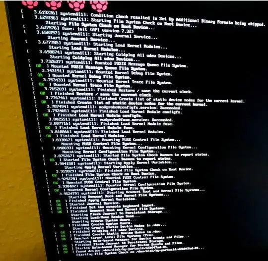

But this minimal example still doesn't work: During the boot, the screen went off and only the red power LED keeps being active. Since the output logs are written fast, I made a video to see if there is any usefull output:
Starting File System Check is the last line, then the screen went black. I found this documentation which indicates that shutting down is the default action. It seems a bit odd to me that this happens before a file system check without any log messages, but it could explain this behavior.
I also tried systemd.run=/boot/ulabs_image2card_init.sh systemd.run_success_action=reboot without any difference. After adding systemd.run_failure_action=reboot the Pi was rebooted. So it seems something went wrong, but what? The minimal script just return 0 which should indicate success. Setting the execute bit doesn't help, too.

It turned out that the script uses CR LF (\r\n). Since I currently used VS, I was running Windows instead of Linux without remembering that Windows uses CRLF as default, where Linux/Unix uses just LF (\n) without CR.
I couldn't find a way to get more logs. It become clear when removing the directives from the cmdline.txt and tried to execute the script manually. After using LF instead of CRLF, the script was called and then the PI rebooted when having
set without systemd.run_failure_action=reboot. To give it more sense, we need to add sed -i 's| systemd.run.*||g' /boot/cmdline.txt in our init script. This removes the systemd.run directives from the kernel parameters after the first boot, so there is no endless boot-loop.
