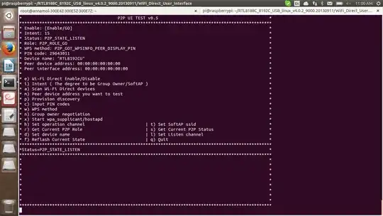

  • When I try to configure the raspberry pi as the group owner using iwpriv commands and using the user interface app provided by Realtek , the devices detect each other but fails at the provision discovery phase and the screen shows started hostapd open and counts till 120 in the user interface and at times as shown in the figure hangs at P2P listen state. I have enabled dhcp and edited the /etc/dhcp/dhcp.conf .

For making the raspberry pi as the group owner I set the intent as 15 and make the peer display the pin for wps and start provision discovery phase.
