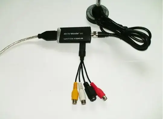

You can use a USB tuner to capture Video in.
Please check here for compatibility
Just make sure to get one that has the extra inputs for SVideo and Analoque input, as well as the terrestrial input.
