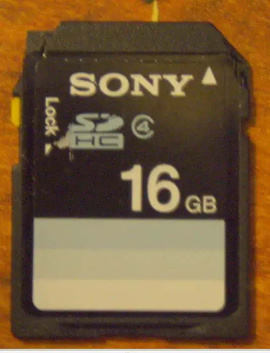

Last night I suddenly found my SDHC card does not work on my card reader of PC. Further investigation shows the SDHC card seems to be damaged on the inner corner (the other side of the "missing corner"). Of cause, it does not work on the Pi as well. In addition to that, a little piece of the SD card can still been found in the Pi's SD card slot.

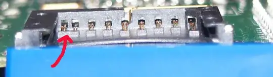

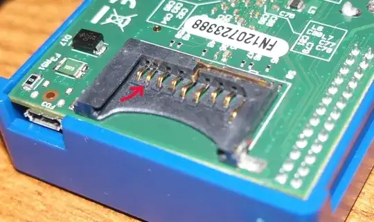

I fixed my Pi. According to investigation, 2 of the SD card slot trampolines was found to be flatten so they are not connect properly. Also, although the real reason of the damage remains unknown, but the most likely suspects are considered to be - my 4yo son and 1.5yo daughter.
Thanks for the commenters, I learn from them to observe the contacts so I can finally bring my Pi back to running!
Pictures for reference:
Damaged SD Card On Left-top corner Flattened trampolines 1 enter image description here
