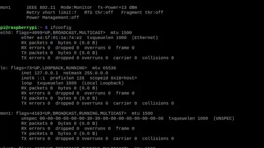

I have also tried setting up a monitor interface by running the sudo iw phy phy1 interface add mon1 type monitor command and then doing ifconfig mon1 up to start it up. Once I do this though the interface does not pick up any packets(i tried changing the channel but am unable to do so as an error is brought up which says device or resource busy), maybe I am misunderstanding how this works. I have attached a few screenshots below showing this approach first being the result of the config command.
Any help with this issue would be much appreciated.
screenshot

This is not an Answer to all the Questions you asked, but may help.
"it either switches my wlan0 and wlan1" this is normal, interface names are assigned in the order they are enumerated and there is no (simple) solution.
The normal Linux approach is to use Predictable Network Interface Names. The internal WiFi will ALWAYS be wlan0 - there is no possible confusion, although it is possible to create a udev rule.
I suggest you Enable predictable network i/f names in the Advanced option of raspi_config. This avoids a race condition which can result in the wrong interface being configured.
Use of /etc/network/interfaces is discouraged in Raspberry Pi OS, although it CAN be used for an interface (such as monitor mode) if you add denyinterfaces … to the end of /etc/dhcpcd.conf (but above any other added interface lines) to prevent dhcpcd from attempting to configure it.
There is no reason to ever use pre-up or similar.
See Prevent dhcpcd from configuring an interface and Predictable Network Interface Names in How to set up networking/WiFi
NOTE You may find other methods of using monitor mode on this Forum.
