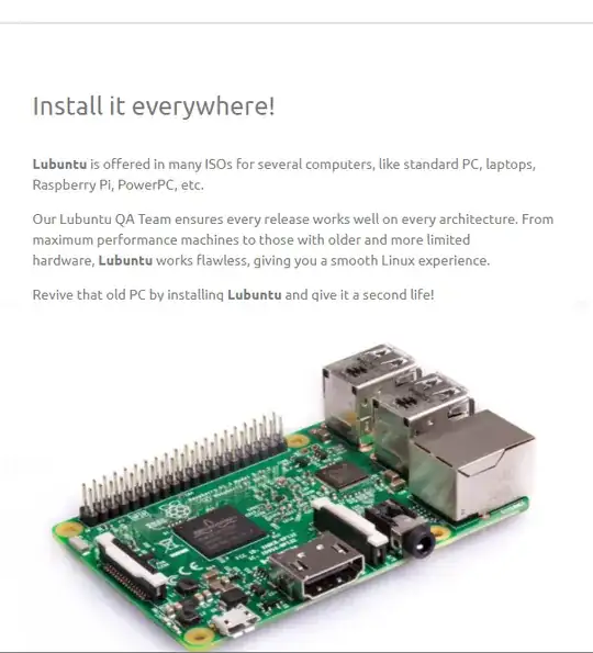

I understand your requirements and after all that I want to suggest you Lubuntu [just a lightweight ubuntu flavour] this is its official website, also its mentioned on Ubuntu's official website.
This screenshot will be helpful for you.
