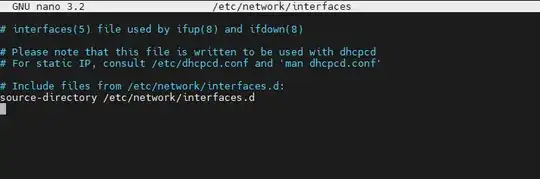

Solution: Instead of rewriting 'wpa_supplicant.conf' using with open('/etc/wpa_supplicant/wpa_supplicant.conf', 'w') as file:, rewrite the 'interfaces' file from the /etc/network/interfaces path.
You will see this initially in the 'interfaces' file: enter image description here
Add this code below the source-directory /etc/network/interfaces.d line:
