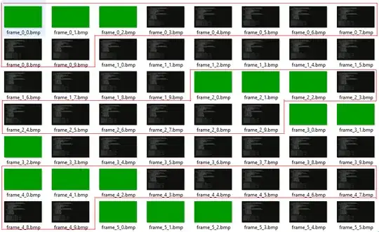

We observe that after device gets opened, we might receive green frames. We are not sure what is the reason of that, but it seems that it's somewhere on either uvcvideo or USB driver side. We tried different capturing resolutions, different FPS settings, different capturing APIs and different cameras, and nothing seems impacting the results. Although if we run the same code on Linux PC, we don't see green frames appearing.
In our test, most of the times, we see several green frames, and then normal frames starting getting captured, until we re-open video device. Sometimes, we don't see green frames at all, but most likely each sequence starts with some green frames.
This picture shows what's I'm talking about:
frame sequences
After digging over the Internet we found some reports of similar issues, but not exactly the one we see. I bet people ignore it, because they just keep device open in their use-cases and ignore the fact that some initial frames are corrupted. It's crucial in our use-cases thought.
