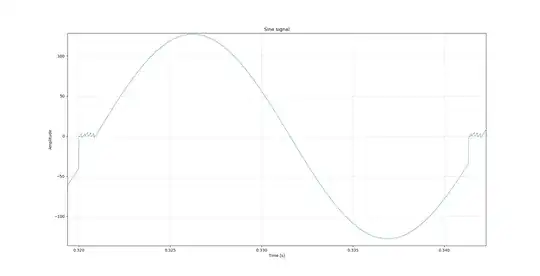

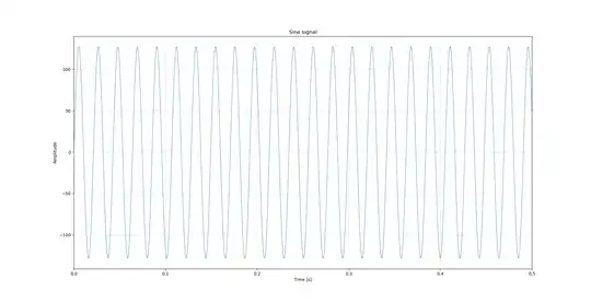

However, when I observe the recorded stream, I can see that there is a gap in audio after every complete period i.e. after transmission of 1024 bytes. Half-second plot of recorded audio stream Zooming in, it can be observed that each gap is roughly about 1 ms in duration. Zoomed in plot This would correspond to a polling interval for a frame for USB-FS which should not be the case since the RPi 3 B+ supports USB 2.0 High-speed.

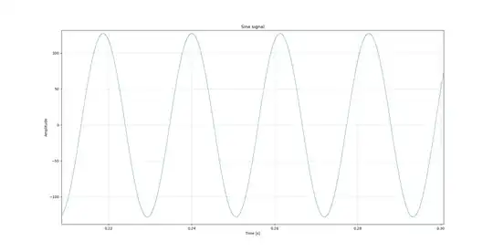

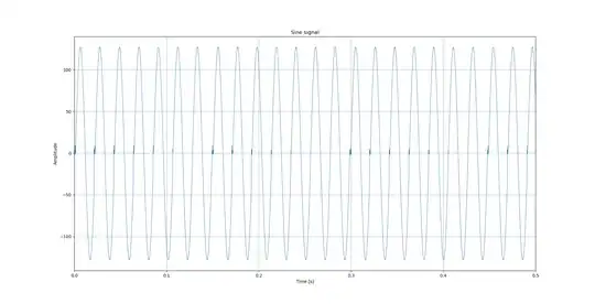

When the Audio device (my programmable embedded device) is configured to bInterval=4, hence polling interval of 1 ms, there is no issue with the recorded audio and no gap is observed after transmission of 1024 bytes (1 complete wave period). Plot of recorded audio when bInterval=4 There appears to be no syncing issues between the audio application (PyAudio) and hardware (USB controller) within the USB host (RPi) since PyAudio after reading the device descriptor would expect each successive 1024 bytes to arrive after 1 ms. Zoomed in plot of recorded audio when bInterval=4
