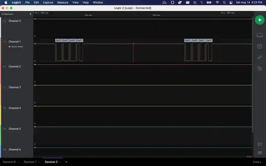

I have enabled uart serial port /dev/ttyAMA0 on my raspberry pi zero W. I was able to successfully connect the rpi uart rx and tx pins and check if i'm able send and receive data between these rpi port. But when i connect to an external source of serial data, my program does not receive anything.
My goal is to receive and process async serial data which looks like this -logic analyser output.

Setup - Connected the TX of the external source to the RX of RPI (physical PIN 10/GPIO 15).
What am i missing?
Karthik
Oops. I forgot to connect the rpi and external TX device to common ground. Once i did that, my code now reads all the messages.
