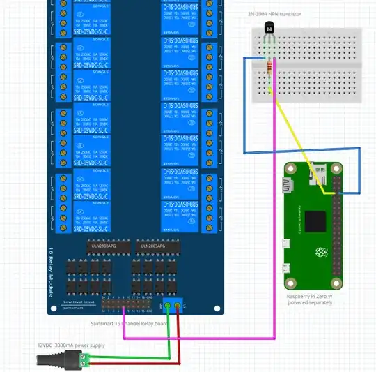

Below shows the current wiring setup between the Pi and the 16 channel relay board. Power is coming from a 3000Ma 12vdc adapter to the relay board and then supplying 5vdc to the Pi. Wiring Diagram

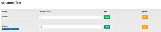

The below screenshot shows the actuators test page where I can trigger the assigned water2 output for 10 seconds but the relay does not disengage after 10 seconds. Hydrosys4 Settings page
To reiterate my question: I can trigger via command line the relay to turn on and off but within the Hydrosys4 App I can get the relay to turn on but not off. I'm asking if anyone has any experience with Hydrosys4 and this issue of the relay NOT turning off? How did you fix this issue?

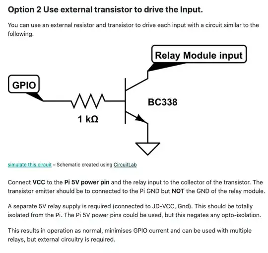

To fix my issue I have added an external transistor to the circuit and changed the logic in the hydrosys4 app to positive logic. enter image description here Now I can use the wiringpi command 'gpio -g write 4 1' to trigger and it turns on, then with the command 'gpio -g write 4 0' to turn off.
