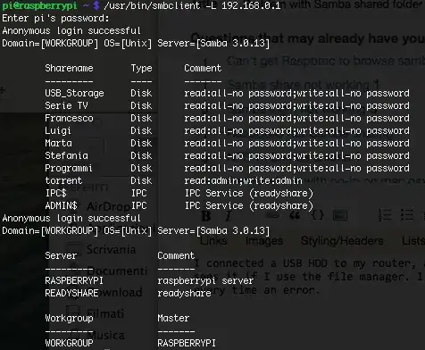

I have a USB HDD formatted in NTFS connected to my router, all my PC(Windows,Os X,Linux) can use it, also Raspberry works on it using the file manager.This is the situation

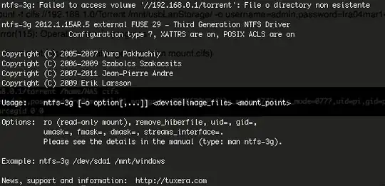

I try to mount the folder torrent by raspberry's terminal using
sudo mount -t ntfs-3g //192.168.0.1/torrent /home/NAS -o username=***,password=***,workgroup=WORKGROUP,file_mode=0777,dir_mode=0777,uid=pi,gid=pi,forceuid,forcegid 0 0
but its outcome is
I try also with cifs instead of ntsf
sudo mount -t cifs //192.168.0.1/torrent /home/NAS -o username=***,password=***,workgroup=WORKGROUP,file_mode=0777,dir_mode=0777,uid=pi,gid=pi,forceuid,forcegid 0 0
But also this time it fails, the result is
I am not able to find the mistake. Someone can help me?
