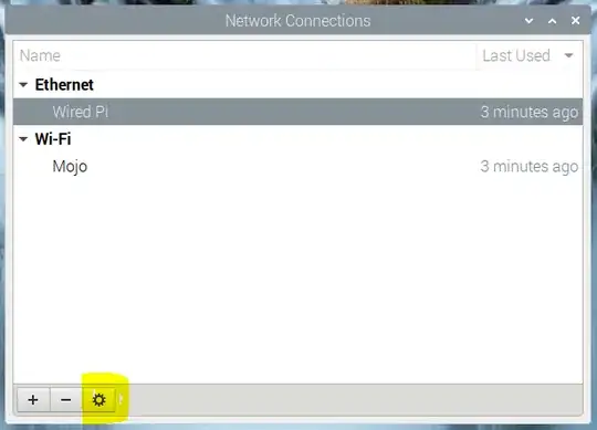

  10. Now connect to a wifi network using the new network manager you will find the the icon NetworkManager Icon on the task bar.
  11. Select each connection and press the settings icon.Select connection press settings in yellow

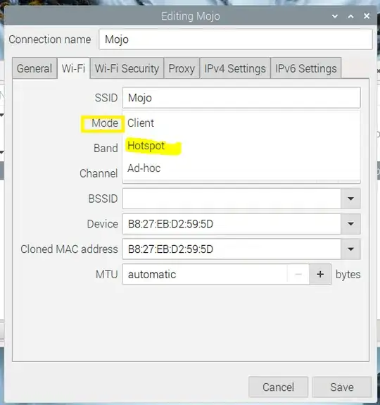

  12. Edit the settings menu to configure to your needs. The image is from selecting the mode pull-down list.Configure WiFi connection Mode
