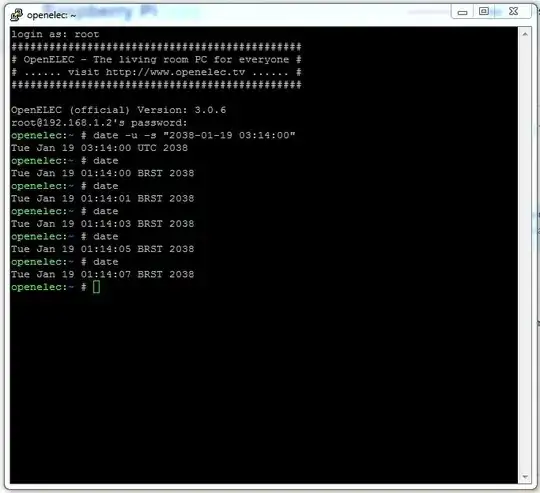

Yes.
Here's the output of a SSH session to my Pi 1 (Model B, 32 bits) running OpenELEC v3.0.6.
It hangs after reaching Y2K38. Not only the SSH session itself stops responding, but OpenELEC freezes as well.
I expect (and hope!) that by 2038 a fix will have been released.
That, or your question will get a lot of upvotes in 24 years.
