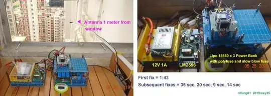

Appendix A - Lipo power bank for Neo GPS
lipo power bank
