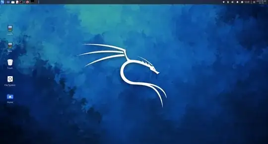

I have a very quick and easy way: First go on your terminal and type 'sudo raspi-config'. Now go down to the advanced options section and hit enter. Now go on the A7 option and hit enter. Go to the E2 option, hit enter, hit enter on yes and ok. Now go down to the advanced options section again, go on Boot order, select USB Boot, enter ok and finish but don't reboot yet. Lastly go on Imager and choose your OS as kali linux: Other specific purpose OS > Kali Linux > Raspberry pi 2,3,4 and 400 (32 bit). Now plug in your USB and go on choose storage using your USB. NOTE: ALL DATA WILL BE DELETED ON USB. Now click write and enter your password and you are done! After it has been written to your USB go on your terminal type 'sudo init 6' your pi should shut down, plug the USB in if you took it out, plug out the power cable and back in the pi and it should work! enter image description here
