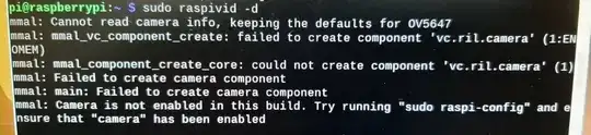

I'm trying to use two RaspiCam V2 with CM3+ and Computer Module 3+ Development Kit board. I followed instructions provided in official links:
and then I followed camera setup procedure provided here. As a first try I focused on single camera procedure, unluckly I immediately stumbled on a first issue:
first issue
On the official forum I found a matching solution here, but following it I got this:
second issue

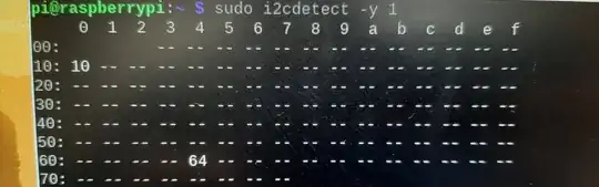

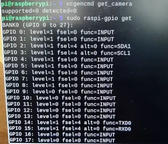

It seems that camera is not found and moreover that I2C bus is supposed to be on GPIO 2 and 3 while the procedure was asking to connect wires on GPIO 0 and 1: I connected bus wires on GPIO 2 and 3 and made a check over I2C trough the following command:
sudo i2c-detect -y 1
now it seems that camera is found (If I'm understanding the following message correctly):
i2c-detect result
but even with such wiring I'm not able to complete the camera setup procedure because I alway got the first message (first issue picture).
