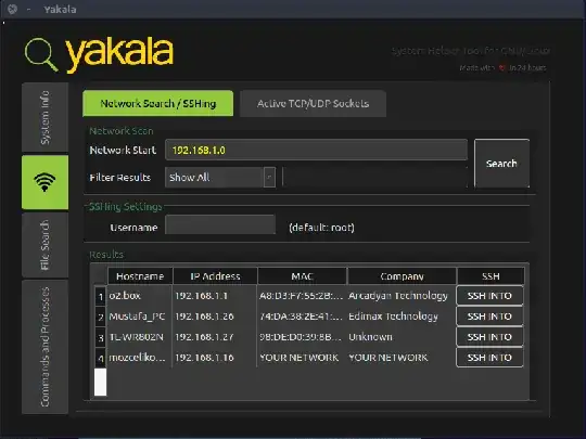

If you want to use a GUI application for it, you can use Yakala tool (https://github.com/mozcelikors/yakala) for Debian/Ubuntu. This tool helps you not only search for available Type B and Type C networks, but also helps you to directly SSH into the network:
sudo add-apt-repository ppa:mozcelikors/yakala
sudo apt-get update
sudo apt-get install yakala
or
git clone https://github.com/mozcelikors/yakala
cd yakala && sudo ./install.sh
https://raw.githubusercontent.com/mozcelikors/yakala/master/docs/img/peekx2.gif
Disclaimer: I am the creator of Yakala. Any suggestions/bugs are taken very seriously.
