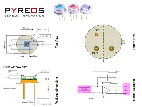

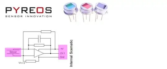

pyreos schematic
Notes
  1. A py0573 bandpass filter is used for CO2 spectrum
  2. To determine if a "flame" exists on the FOV of the sensor, the vendor recommends a plot/detect FFT bins from the 5-15hz frequency.
Electrical Characteristics
  1. Max. Voltage (+V) = 8.0 V
  2. Min. Voltage (+V) = 2.7 V
  3. Output voltage normalised around mid-rail
  4. Time Constant = ~12 ms
  5. Op-Amp with 10 GΩ feedback resistor

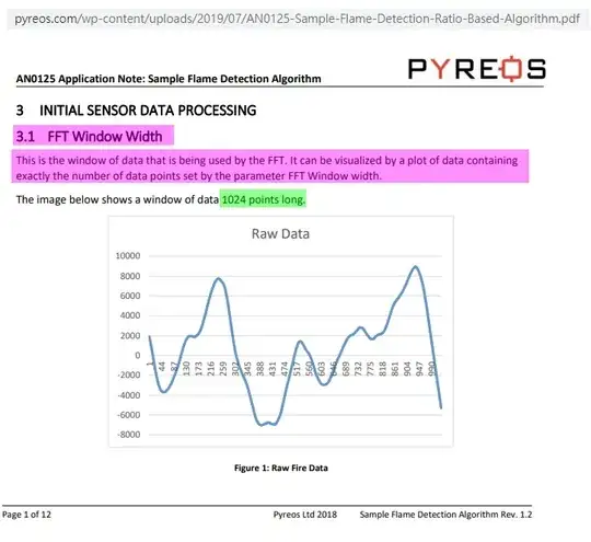

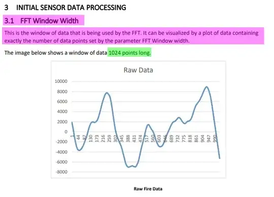

Part 1 - Using MCP3008 to read raw data
First thing first is to prepare 1,024 flame sensor readings for FFT. (See Reference 6 and Appendix B below for more details.)
FFT Raw Data

Appendix A - Pyroelectric Flame Sensor PY-ITV Datasheet Summary
Introduction
The Pyreos thin film pyroelectric infrared flame detectors offer exceptionally high responsivity, a wide field of view of typically 100° (*subject to filter band pass specification) and class leading rapid recovery from thermal and electrical shocks (<1 second downtime). This current mode sensor has excellent signal to noise at the signature 8-10 Hz flicker range of a flame, and can provide accurate discrimination of flame sources in triple IR flame detection systems.
The sensor element is built into a low noise circuit that has an internal CMOS op amp with a 10GΩ feedback resistor outputting a voltage signal centred around half the supply rail.
Sensor Characteristics
Filter aperture = 5.2 mm x 4.2 mm
Element size = 1000 µm x 1000 µm
Package = TO39
Responsivity = 1 150,000 V/W
D* = 3.5 x 108 cm√Hz/ W
Noise = Mean 70 µV√Hz
Field of View = Typical 100°
Operating Temperature = -40 to +85 °C
Storage Temperature = -40 to +110 °C
Filter As per Filters Available table
Appendix B - Package Info and Internal Schematic
package info and schematic
Appendix C - Example Raw Data for FFT
example raw data

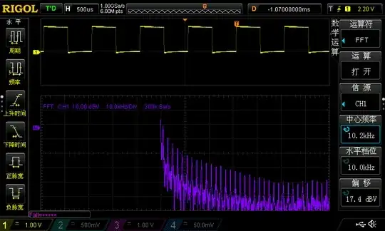

Appendix D - Rigol DS1504Z 50MHz 1Gsp/s Scope 1KHz square wave signal FFT Test
fft test
