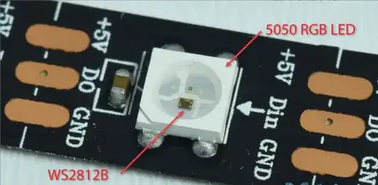

Each of one the BCM GPIO D18, D21, D10, D12 can independently control a WS2812B RGB LED strip.
Notice
  1. If there are more than 30 LEDs in a strip, an external power supply needs to be added;
  2. If you want to use BCM GPIO D10 or D12, you must first enable SPI on the Raspberry Pi;
By the way: Each 5050 RGB LED will draw 20mA(min) to 60mA(max)
