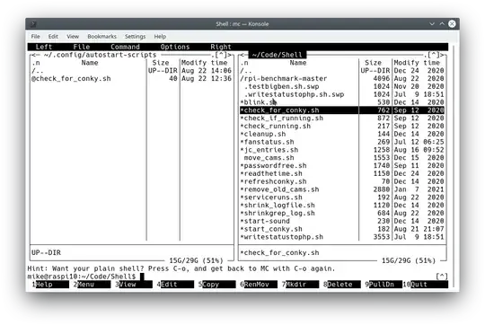

Although this topic is not new, the autostart problem resurfaced newly again. The fact that Conky was not auto-starting anymore, made me aware of this new issue.
After some unsuccessful efforts by using the latest hints that I found on the web, I tried:
    /home/myusername/.config/autostart-scripts
by adding a symlink to a shell-script (see image below) . The script:
#!/bin/bash
stat='df -h'              # get status of mounted drives
$stat > ~/startstatus     # and (over)write to file startstatus
stat2="sudo systemctl status home_autom"  # get the status of service
$stat2 >> ~/startstatus   # and append to above file
sleep 45 conky -obdq # start conky
Now conky pops up again at boottime. By checking the modification date of the file startstatus can be verified whether the script worked or failed.
My system: Raspberry 3 B+ Linux raspi10 5.10.52-v7+ #1441 SMP Tue Aug 3 18:10:09 BST 2021 armv7l GNU/Linux Raspbian lite + KDE
screenshot midnight commander
