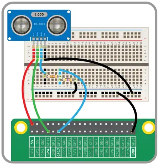

My Circuit:
The Vcc pin on the HC-SR04-Ultrasonic Sensor is connected to the 5V power supply on the raspberry pi, then the Trig pin is connected to the 4th GPIO connector on the board the echo pin is then connected to the 17th GPIO connector between a voltage divider consisting of a 330 ohm resistor and a 470 ohm resistor Wich protects the raspberry from a full 5V
My circuit looks like: circuit
