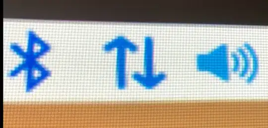

Result: All 4 files has been created sucessfully and the AP is running so that I can connect into it, but my Raspberry doesn't get any internet connection. I tried with different networks but I never got my Raspi connected with any network. I don't use any MAC filter or any restrictions on my Fritzbox. I also tried to connect to a secured and also an unsecured mobile phone hotspot and failed as well.
It shows following icon:
I also even can't connect to any wifi manually anymore, have first to delete all the created config files and then it is possible again. I tried several times to repeat all the steps but it just doesn't work.
