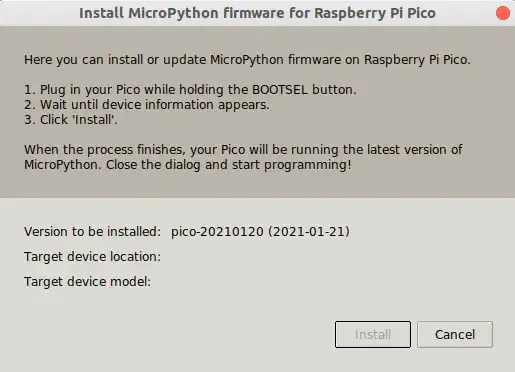

I am trying to connect to Raspberry Pi pico using Thonny. I am using Ubuntu 20.04.
Giving Error
Couldn't find the device automatically.
Check the connection (making sure the device is not in bootloader mode) or choose
"Configure interpreter" in the interpreter menu (bottom-right corner of the window)
to select specific port or another interpreter.
Tried to install firmware
In Tools>Options>Install or update firmware I pushed BOOTSEL button, but it is not changing anything.

Press and hold BOOTSEL button while you connecting it to USB of your computer. Release it after connected. Copy UF2 file to newly mounted PRI-PR2 storage. It will restart, ready to go. According to Getting Started:
  1. Download the MicroPython UF2 file...
  2. Push and hold the BOOTSEL button and plug your Pico into the USB port of your Raspberry Pi or other computer. Release the BOOTSEL
    button after your Pico is connected.
  3. It will mount as a Mass Storage Device called RPI-RP2.
  4. Drag and drop the MicroPython UF2 file onto the RPI-RP2 volume. Your Pico will reboot. You are now running MicroPython.

Just to give some more attention to Aiden L's answer: If your Pico really doesn't cooperate, try completely resetting it with flash_nuke.uf2 (file from adafruit.com). This was the only solution that worked for me.
I have noticed that when you try to install the Pico's firmware from Options->Interpreter it leads to that issue.
A possible solution which I have found is disconnect the Pico, press BOOTSEL connect it, and choose it from the bottom right corner. A firmware instillation window will appear, and it updates the Pico without any issues.
