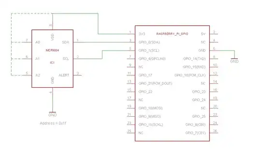

Here's how to connect a MCP9804.
You can use it like this:
root@raspberrypi:~# modprobe i2c-dev
root@raspberrypi:~# modprobe i2c-bcm2708
root@raspberrypi:~# i2cdetect -y 0
     0  1  2  3  4  5  6  7  8  9  a  b  c  d  e  f
00:          -- -- -- -- -- -- -- -- -- -- -- -- --
10: -- -- -- -- -- -- -- -- -- -- -- -- -- -- -- 1f
20: -- -- -- -- -- -- -- -- -- -- -- -- -- -- -- --
30: -- -- -- -- -- -- -- -- -- -- -- -- -- -- -- --
40: -- -- -- -- -- -- -- -- -- -- -- -- -- -- -- --
50: -- -- -- -- -- -- -- -- -- -- -- -- -- -- -- --
60: -- -- -- -- -- -- -- -- -- -- -- -- -- -- -- --
70: -- -- -- -- -- -- -- --
root@raspberrypi:~# i2cget -y 0 0x1f 0x5 w
0x67c1
Converting 0x67c1 to a temperature is a little convoluted. The MSB is 0xc1 and the LSB is 0x67
The first 4 bits of the MSB are dropped and which leaves the temperature in 16ths of a degree
(0xc1&0xf)*16+0x67/16.0 = 22.4375 degrees

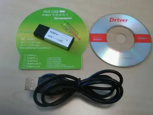

A simple, cheap USB "HID TEMPer" thermometer also works, and is much easier to connect for those who are yet to fiddle with UARTs or GPIO, like me.
HID TEMPer USB thermometer
My RPi provides enough power to drive it directly from the USB port without a hub.
To set this up with Raspbian Wheezy, I followed these instructions which were written for Ubuntu (disclaimer: link is for a post on my own blog). For the Raspberry Pi, I only had to make one small tweak to set LIBUSB_LIBDIR when installing the Device::USB perl module so it could find libusb in the non-standard arm location. The complete instructions follow.
