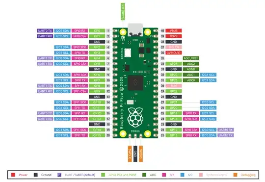

Hardware
To wire the sensor to your Pico:
  • Connect the sensor's ground to one of the ground pins on the Pico.
  • Connect the sensor's VCC pin to the Pico's 3.3V(out) pin.
  • Connect the Sensor's data pin to the Pico's GPIO4
Raspberry Pi Pico Pinout
