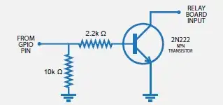

If anyone cares, I have wired the relays to the RPi using this circuit (from Sainsmart) which converts them from "active low" to "active high":

The code Joan posted will work, but that does not mean the relays will.
These relay modules are unsuitable for the Pi as they are only controllable from 5V.
Attempting to run them risks damage to the Pi and they do not work reliably.
Can you use a 5V Relay Module with the Pi? describes these and suggests modifications to make them work.
In addition you could not use 8 as this would exceed the rating of the Pi GPIO.
