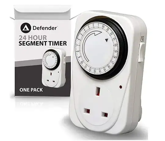

To underscore the "Return-on-Investment" point made earlier, this device could be part of a "power-saving" solution:
Outlet Timer
Plug your RPi power supply into this device, set its timer to switch power off at the desired time, and then just before that time invoke the shutdown in a crontab as shown above (to help prevent file system corruption).
But here's the best part: The cost of £7.49 will be amortized in less than 2 years.
