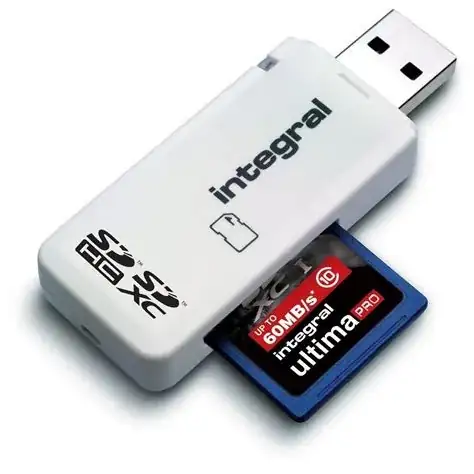

    Devices such as this may come in handy:
USB-SD adapter
