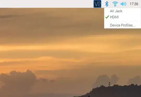

If you're using raspbian you could try this:
In the top right, there is a volume icon, if you right click that you should probably see the HDMI option, make sure there's a green check mark next to it.
HDMI Option
See if you can set the default audio sink device in Pulse Audio Volume Control settings, as described in this answer. Pulse settings are user-specific, so this has to be done for every user you create.
