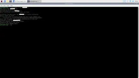

I need to connect to work VPN on my raspberry PI. I have been given ID, Password and server. Using Kerio Control VPN software on my windows machine to connect to the VPN. I cannot figure out how can I do that on my raspberry PI since I need to access some links on my raspberry. The only guide I have managed to find is the following: Raspberry Pi 3 How to connect to work VPN
However, I am getting nowhere by attempting to use these commands :
Perhaps someone have more experience with Raspberry PI and VPN than me and can give me any sort of advice?

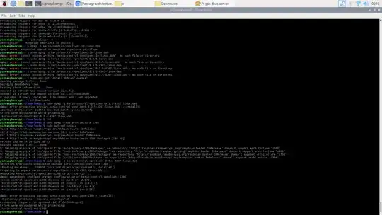

Since openVPN did not work for me straight away, I have decided to give it a shot using Kerio VPN client since I use it on Windows already.
I have downloaded debian file and followed the instructions: https://support.keriocontrol.gfi.com/hc/en-us/articles/360015190599
Initially, I had some error regarding the unmatched architecture:
package architecture (i386) does not match system (armhf)
Based on a quick google search, I have decided to try and add the architecture using command:
sudo dpkg --add-architecture i386
After this command, the installation of the Kerio VPN proceeded but still not fully,the full error message can be seen here:
 sudo dpkg -i kerio-control-vpnclient-9.3.5-4367-linux.deb
Selecting previously unselected package kerio-control-vpnclient:i386.
(Reading database ... 118878 files and directories currently installed.)
Preparing to unpack kerio-control-vpnclient-9.3.5-4367-linux.deb ...
Unpacking kerio-control-vpnclient:i386 (9.3.5.4367-1) ...
dpkg: dependency problems prevent configuration of kerio-control-vpnclient:i386:
 kerio-control-vpnclient:i386 depends on libc6 (>= 2.17).
 kerio-control-vpnclient:i386 depends on libgcc1 (>= 1:4.1.1).
 kerio-control-vpnclient:i386 depends on libstdc++6 (>= 4.9).
 kerio-control-vpnclient:i386 depends on libuuid1 (>= 2.16).
dpkg: error processing package kerio-control-vpnclient:i386 (--install): dependency problems - leaving unconfigured Processing triggers for systemd (241-7~deb10u4+rpi1) ... Errors were encountered while processing: kerio-control-vpnclient:i386
or the image:
Really appreciate any kind of advice! I believe the issue lies here:
But I am not certain how to fix that

The software you are trying to load will not work on the Pi as it is compiled (created) for the Intel / AMD series of chips (that's the i386 above) and the Pi does not use that. GFI is not very good at stating the Linux chipset on their documentation but always look for the Pi by name.
I recommend that you ask your IT department for help as you do not want to create a security alert on their intrusion detection system and get your IP blocked.
You could also enquire if the firewall can be set to allow IPSec security and then use the OpenVPN client to access it that way.
