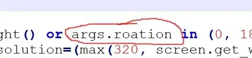

P.S. What also confused me further is that pitft_labeled_output.py has a typo in line 56 and runs fine anyway, but when I ran my code for the first time, it asked me to correct the error. enter image description here

I'm also surprised that pitft_labeled_output.py runs with a typo in main(), perhaps you should double-check what you run exactly.
