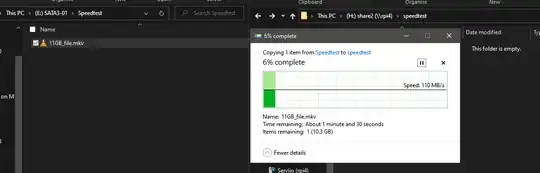

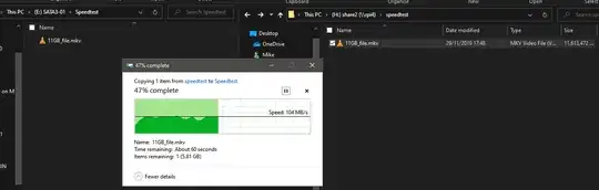

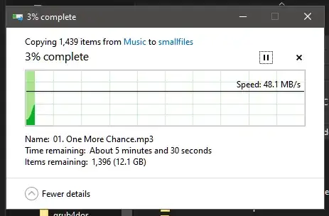

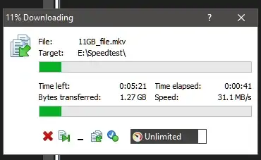

I have an Rpi4 8GB with a WD Elements 2TB USB3 external HDD (USB3 powered from the Pi) and a Seagate Backup Plus USB 3TB (with its own power supply), both shared by the Pi using Samba and I can get 100 Mbyte/sec each way from either on my LAN, maxing out the Gigabit Ethernet. SFTP is slow because of encryption/decryption. Also, if the drives are formatted NTFS then any Linux server is going to bog down because of the CPU load. My Samba shares are formatted ext4.
(1) 11.6 GB file from Pi to Windows PC
(2) The same file from Windows PC to Pi
(3) You will not get such high speeds with lots of small files (Rpi to Windows PC)
(4) For comparison, using WinSCP for an SFTP transfer from Pi to Windows PC.

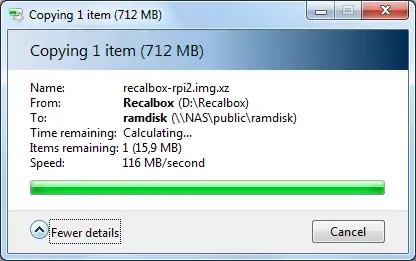

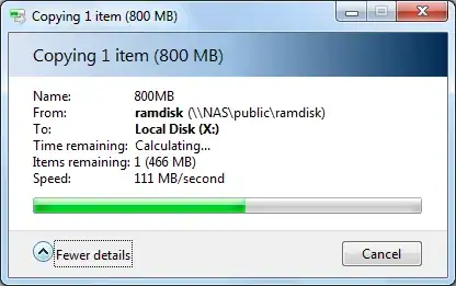

Now that I bought the official RPi power supply, it is no more throttled (throttled=0x0), and I can enjoy 110 MB/s speed when transferring from RPi ramdisk to computer over a Samba share (both RPi and computer with 1Gbps ethernet cables).
I did a similar test in the other way, sending from computer to RPi (ramdisk), and I get similar speed:
