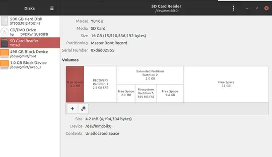

Now I've managed to delete all the partitions on the SD drive and Retropi wont upload without the apparently. Does anyone know if I can reinstall the partitions on an SD Reader? It seems possible but I'd rather not do more damage if avoidable...
Any help would be greatly appriciated! Thanks enter image description here
If you have a back-up SD card, I would simply try again from scratch. It sounds as though you're trying to preserve the current partitioning of it whilst attempting a reformat. It doesn't work like that. You have to start from the beginning with a fresh card.
