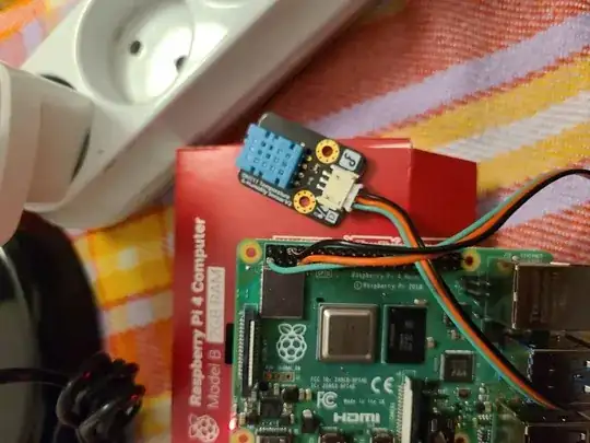

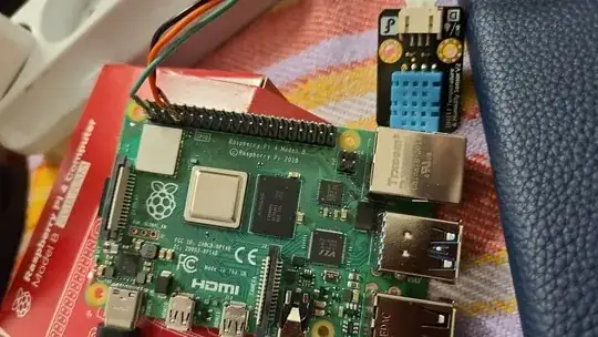

enter image description hereI am using raspberry pi 4 model b and sensor DHT 11 for checking the humidity and temperature. When I am using the code DHT.py, the result is:

the datasheet of sensor is DFR0067 DFROBOT enter image description here enter image description here

I think (unless you have not corrected it yet) you have your wires wrong. The green one is the signal (data) and you have it connected to the 3V3.

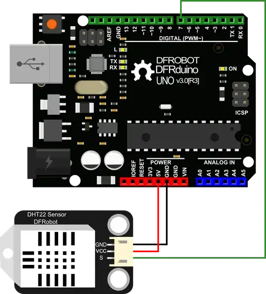

Example how to connect to DFRduino
Source: DFRobot - SEN0137 DHT22 Temperature and humidity module
