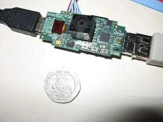

There were 4 different hardware revisions to the Raspberry Pi Model B. Prototyping of the first hardware revision started in 2006:
In 2006, early concepts of the Raspberry Pi were based on the Atmel ATmega644 microcontroller. Its schematics and PCB layout are available for public download. Foundation trustee Eben Upton assembled a group of teachers, academics and computer enthusiasts to devise a computer to inspire children. The computer is inspired by Acorn's BBC Micro of 1981. The first ARM prototype version of the computer was mounted in a package the same size as a USB memory stick. It had a USB port on one end and an HDMI port on the other.
First Raspberry Pi prototype

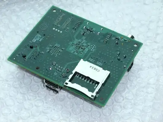

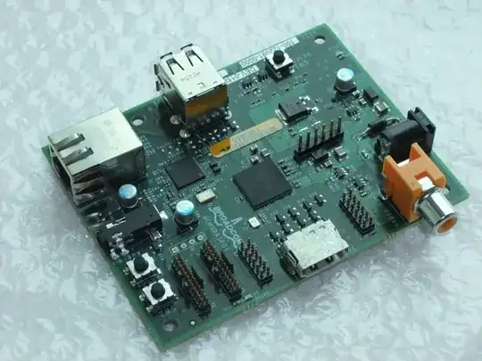

The second hardware revision was a bit larger and had some more features:
In August 2011, fifty Alpha boards were manufactured. These boards were functionally identical to the planned model B, but were physically larger to accommodate debug headers. Demonstrations of the board showed it running the LXDE desktop on Debian, Quake 3 at 1080p, and Full HD MPEG-4 video over HDMI.
Raspberry Pi alpha prototype

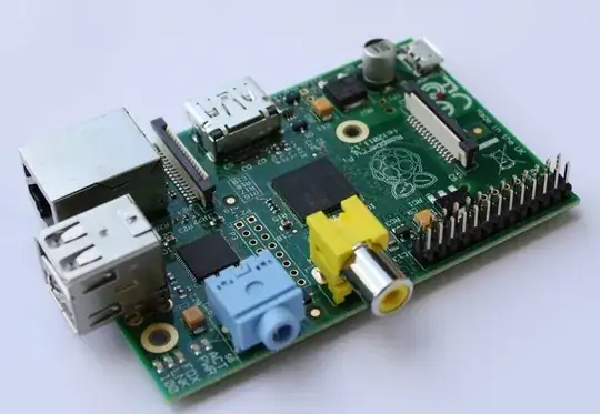

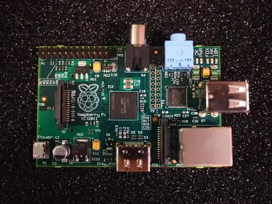

Later in the same year the alpha boards were produced, they came out with the model B beta boards:
In December 2011, twenty-five model B Beta boards were assembled and tested from one hundred unpopulated PCBs. The component layout of the Beta boards was the same as on production boards. A single error was discovered in the board design where some pins on the CPU were not held high; it was fixed for the first production run. The Beta boards were demonstrated booting Linux, playing a 1080p movie trailer and the Rightware Samurai OpenGL ES benchmark.
Raspberry Pi beta prototype

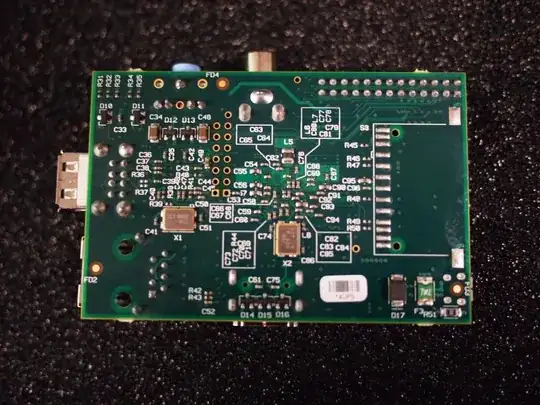

After the beta boards were launched another hardware revision was introduced:
On 5 September 2012, a revision 2.0 board was announced, with a number of minor corrections and improvements.
On 15 October 2012, the Raspberry Pi foundation announced that all new Raspberry Pi model B's would be fitted with 512 MB instead of 256 MB RAM.
